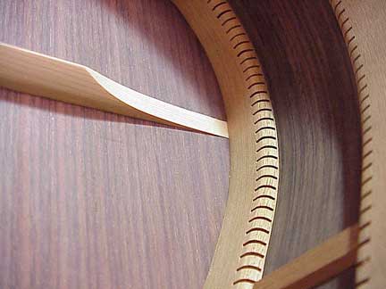

I know that Paul Woolson does it this way, I believe he learned this process from Charles Fox. I was wondering, does anybody else do it like this?
I am VERY interested in this style, Its SO clean!
What are the "do's and dont's" How is this done?
Paul! I know your headed to Montreal, if you have a second, chime in!
Thanks!

It looks more like what I would have called "feathered" than "tucked". When I
refer to tucked braces I think of an end height of 1/16"-3/32" fit to a pocket
cut at the side. It looks like this is just very cleanly feathered down to a few
thousandths by the time it reaches the kerfing. This is what I used to do on
all tone bars and wing braces. Gibson did it for years on thier cheaper
unbound backs, though often not quite so clean.
PostPosted: Fri Jul 06, 2007 1:52 am
Posts: 954
Lance,
This is what I do as well, I just feather the brace out to nearly nothing, just leaving a hint of brace with an upside down chisel...I don't know how many 1000/nds are left under the kerfing, but it isn't much. I also run the "nearly nothing" feathered section the full width of the kerfing, not sure if it really matters but that's what I do.

PostPosted: Fri Jul 06, 2007 8:16 am
Posts: 115
Lance,
Charles tapers the braces on the back as shown in the picture - leaving it only a few thousandths thick - relying on compression to make the fit.  He said he does it this way on the back for cosmetic reasons.  On the top bracing he tapers the braces to nothing, leaving them short of the lining - not tucked at all.  I asked him if he ever had problems with braces coming loose, and he said he's been doing it this way for over 30 years and has never had a problem.
PostPosted: Fri Jul 06, 2007 8:23 am
I have just start doing that on to my back braces on the last several guitars. I've done that right along on the top braces except forward of the sound hole.
I fit the back to the sides while still in the form and mark the intersection and then carefully feather the brace to that point. If you get it real close, the linign will compress and look clean. You are the master of clean brace to lining fits so you shouldn't have any problem.

PostPosted: Mon Jul 09, 2007 7:35 am
Lance, sorry for the late response, I just rolled in from Montreal.
To your questions of do's and don'ts:
Do feather them to exactly zero at exactly the lining. (Trust me, it's easier said than done)
Don't be tempted to leave them a little thick and chop off the ends right at the linings. You'll pop a brace very quickly that way.
In hindsight, it's actually harder to learn than notching the linings. I did one with notched linings once (about my 5th guitar) and it was easier than stopping short at that time. For me now, it's second nature so it not so bad.

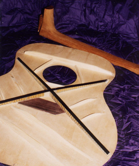

PostPosted: Mon Jul 09, 2007 4:21 pm
Posts: 2996
Hey Rick,
Check this out! It was my first guitar back in 95 or so.
The braces are nomex honeycomb with unidirectional carbon fiber top skins. It's over braced for sure but it's certainly not a dud. I often wonder why I haven't pursued this deeper.
Maybe I'll get back to it some time.
Quite a bit off the original topic, sorry bout that.
PostPosted: Tue Jul 10, 2007 3:36 pm
Posts: 1398
Jim, very interesting, to say the least! That sucker has to be incredibly stiff across that "X". That's pretty much what I'm doing on back braces except they're spruce and CF.
PostPosted: Tue Jul 10, 2007 4:19 pm
Posts: 2996
It'll compete with any helicopter on the planet! (many helicopter blades are the same construction)
I think there's something here but not in this exact configuration. Maybe I'll try it on the back sometime like you do, if you don't mind.
